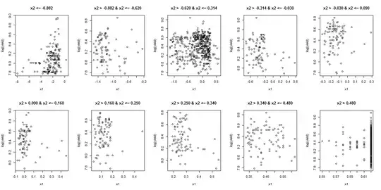

I followed the suggesting in the comment and plotted x1 and log yield for different range of x2 and this is what I get. Could anyone tell me what does it tell me w.r.t to why the signs of x1 and x2 are opposite in the model and if does it affect my predictions (I am more interested in the prediction than the sign of the regression coefficient itself).

  • Separating the observations into groups is too crude to provide insight into this relatively subtle effect. Instead, regress log(yield) and x1 separately against x2 and examine a scatterplot of the residuals on which a linear fit has been superimposed. You will then be able to see the negative trend and the reason for it. There is a slight but definite change in behavior for $x_1 \lt 0.62$ vs $x_1 \gt 0.62.$ This is entirely buried in the stack of points in the last scatterplot you show, making it impossible to see. – whuber Nov 26 '18 at 23:43

  • In 10 grouped scatterplots of x1 vs log(yields), it is hard to find the positive relation between them. Some of them implies negative relation. It means that when X2 is fixed, X1 and log(yield) has no relation or weak negative relation. It is what " x1 -0.07341 " means. – user158565 Nov 27 '18 at 01:19
