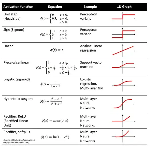

In the hidden layers we may use whatever activation function we like. What's crucial are the output activation functions for each parameter as they have to be compatible with the support of the parameters.
Some example correspondence:
  • Linear activation: $\mu$, mean of Gaussian distribution
  • Logistic activation: $\mu$, mean of Bernoulli distribution
  • Softplus activation: $\sigma$, standard deviation of Gaussian distribution, shape parameters of Gamma distribution

*ReLU is unfortunately not a particularly good activation function for $(0,\infty)$ due to two reasons. First of all it has a dead derivative zone on the left quadrant which causes optimization algorithms to get trapped. Secondly at exactly 0 value, many distributions would go singular for the value of the parameter. For this reason it is usually common practice to add a small value $\epsilon$ to assist off-the shelf optimizers and for numerical stability.
As suggested by @Sycorax Softplus activation is a much better replacement as it doesn't have a dead derivative zone.
