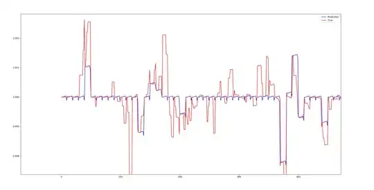

My current project is a time series forecasting problem which has as purpose working on the price movement. Actually, the prediction are correct and I think we are still having some place for improvements. To deal with that question, we work with Deep Neural Network. Particularly, it is a regression problem where we use LSTM (i.e. a type of neural network). So we need features and a target. For some good reasons, we don't want to work on the price directly as target, but on the log-return instead, i.e. $\log(\frac{P_t}{P_{t-1}})$ where $P_t$, $P_{t-1}$ are two consecutive prices.
For good reasons, we decided to apply the log-return on the price as well as on the features. For the sake of that question, let's define $\log(\frac{F_t}{F_{t-1}})$ where $F_t$, $F_{t-1}$ are two consecutive features.
As there's quite a lot of stability in the features and the price, then the model tends to predict something near zero. Therefore, I would like quietly to remove useless, irrelevant data. Let me describe my needs ...

  • Aside from my comment on the signal to noise ratio (which was a bit of-topic) I wonder why you consider adjusting the data table (instead of considering a different loss function) in order to solve the problem "the model tends to predict something near zero.". And what makes you believe something is "irrelevant data."? The answer to "a method to measure the similarity in the features" is very broad. It can be answered with more information about the actual hypothesis on the relationship or behavior of the features and prices (which is more economics than statistics). – Sextus Empiricus Nov 19 '18 at 15:02
