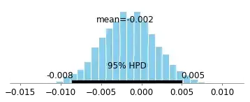

no bias
Here's the 95% Credible Interval when looking at the full data set (i.e. not conditioning on those who survived).
95% credible interval, no bias.
It is densely centered at 0, which essentially shows no association at all.
In real-life examples, things might not be so simple. There may be many more variables that might cause systematic bias (confounding, selection bias, etc.). What to adjust for in analyses has been mathematized by Pearl; algorithms can suggest which variable to adjust for, or even tell us when adjusting is not enough to remove systematic bias. With this formal theory set in place, we don't need to spend so much time arguing about what to adjust for and what not to adjust for; we can quickly reach conclusions as to whether or not our results are sound. We can design our experiments better, we can analyze observational data more easily.
