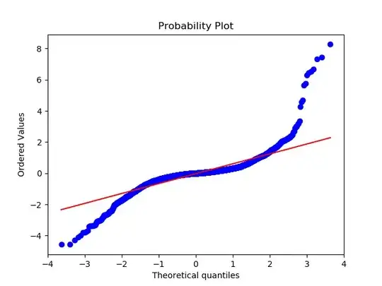

I have a dataset of metric distances ($n=5800$) and plotted those as a histogram. My initial thought was that this distribution looks normal. But after performing a Shapiro Wilk test and plotting the distribution like below I am not that sure anymore. In the Shapiro Wilk test the p value was way to low.
My question is: Can this distribution still be considered as a Gaussian distribution? The mean of my data is -0.027 and standard deviation is 0.72.
Also a qq plot doesn't look like a normal distribution to me. But I am also not sure how to define this distribution.
When limiting my data range to -1.4 and 1.4 the qq plot looks like the following. How can this be interpreted?
Edit: Did a new plot with different software this time. Now the plot doesn't look normally distributed to me anymore.

    The probability plot is inconsistent with the density plot at the outset. – whuber Nov 06 '18 at 18:51
  • Can you elaborate on that please? What could be the reason for that? – conste Nov 06 '18 at 18:59
    The most likely reasons are that the density plot was computed from other data or else was not computed using an appropriate algorithm. – whuber Nov 06 '18 at 21:03
    Ok, I see what you mean. I did another plot, this time using the python package seaborn. Now the density plot is not looking that normally distributed anymore. Added the new plot to my question. – conste Nov 06 '18 at 21:40
    This leads me to suspect the original plot might have been a density estimate using a Gaussian kernel with overly wide bandwidth. The kernel dominated the data, making them look almost Normal. It's a nice example of why probability plots are superior to histograms and density plots for understanding the details of data distributions. – whuber Nov 06 '18 at 21:47

Considering $n=5800$, which is a huge sample, I'd not accept those qqplots. Your second qqplot suggests your smaller observations are too small to be from a normal distribution, and your larger observations are too big to be from a normal distribution. Your tail probabilities are too heavy for a normal distribution.
I don't know what the distribution is. Your data is probably some sort of ratio of random variables. Perhaps the distribution is Cauchy? or t?
