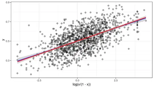

A logit transformation of $y$ is unlikely to help here, rather, a logit transformation of $x$ since it bends outwards. We can shrink the middle $x$ values somewhat and expand the larger $x$ values:
ggplot(dat, aes(log(x / (1 - x)), y)) + geom_point(shape = 1) + theme_bw() +
  geom_smooth() + geom_smooth(method = "lm", se = FALSE, col = "red")
And this time, the linear fit approximates the smoothed fit quite well, not so well at the tails, but good enough for most applications. And homoskedasticity is a plausible assumption.
So the regression model of choice is then:
coef(summary(fit.lm <- lm(y ~ log(x / (1 - x)), dat)))
                 Estimate  Std. Error   t value      Pr(>|t|)
(Intercept)    0.50116288 0.002897402 172.96973  0.000000e+00
log(x/(1 - x)) 0.05446613 0.002045560  26.62652 6.846189e-124
When the predicted log-odds are zero, we expect the win probability to be about 50%. A log-odd higher, and expectation is 5% higher. As seen in the second plot above, the log-odds don't go any further than 5 in either direction. So all the predicted values of $y$ are bound between about 25% and 75%. The regression effect is clear enough and at a large enough sample size that I trust that the inference is not misleading overall. There are always alternatives for better precision.
We can also get a sense of the error about the fitted line.
sigma(fit.lm)
[1] 0.09958555
Given a prediction, about 95% of values should be within about $\pm20\%$. The interval when added to the minimum and maximum predicted $y$ also lies within bounds.
The justification for the linear approach is its simplicity and its adequacy in this particular application.
