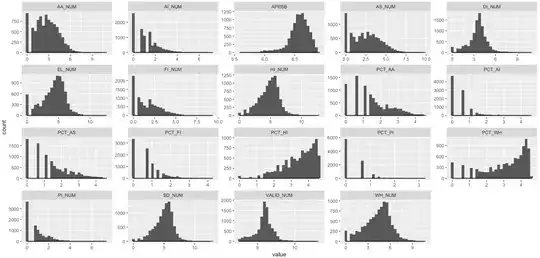

I have dataset with 9524 observations / 97 variables.
Most of variables are numerical, and some of factor variables (Yes/no or several levels)
I want to perform multiple linear regression with this dataset.
  1. First step was to do log transformation on the data, since the data is highly skewed. (I did log(x+1) because of many have 0)
These are the histograms of my data after log transformation. enter image description here
"API05B" will be dependent variable for the linear regression.
There's more variables, and most of them are heavily skewed. (mostly right or some left)

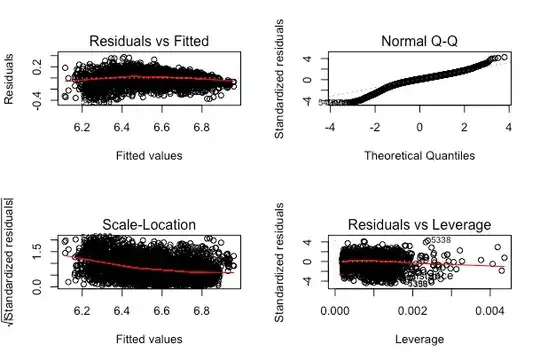

  1. Diagnosis for the linear model - outliers / multicollinearity / heteroskedasticity
I removed outliers / correct the multicollinearity with VIF.
There was no problem with these, but..
I did lmtest::bptest / lmtest::coeftest, the result saying the heteroskedasticity exist.
Box-cox transformation didn't work as well.
Here's the summary plot of my final model.
I've read several articles about dealing with skewed data or heteroskedasticity,
most of them saying log transformation or box-cox transformation would be helpful, but it didn't work..
Some of them recommend to not stick to linear regression, such as trying robust linear regression / zero-inflated model / two-part models etc..

    Something to keep in mind, the heteroskedasticity test need to be taken with a grain of salt, especially for large samples, since the test will in these cases often times easily reject the null. The distributions of your variables does not matter, the residual plots look mostly fine, except for the decreasing variance towards the right end. Have you tried building a model without transformations? – user2974951 Oct 26 '18 at 05:14
  • Yes,I've built the model without transformation. I guess everything worked well, but only the heteroskedasticity problem. – David Kwon Oct 28 '18 at 22:22
  • Depending on what linear model you used, you could: 1) use residualPlots() from the car package to see which variables are causing problems, 2) use weights argument from the nlme package to model the variance. – user2974951 Oct 29 '18 at 08:44

It is seems you may have some mis-understandings on linear regression assumptions. Linear regression does not assume independent variable / model input to be Gaussian distributed, but assume the residual.
Details can be found
Why is the normality of residuals "barely important at all" for the purpose of estimating the regression line?
Why linear regression has assumption on residual but generalized linear model has assumptions on response?
In the first link I provided, it also explains normality of residuals is not that important as you may think.
