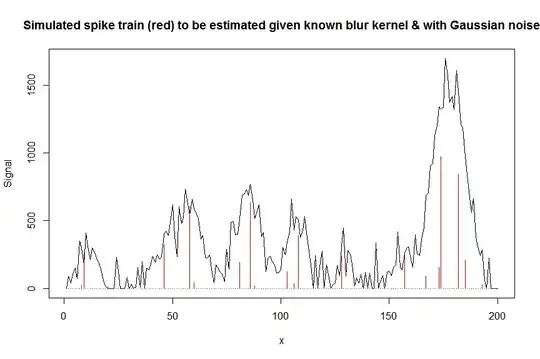

Here is a numerical example illustrating this approach, here in the context of deconvoluting a superposition of gaussian-shaped chromatographic peaks with Gaussian noise on them : (any comments welcome)
First let's simulate some data :
require(Matrix)
n = 200
x = 1:n
npeaks = 20
set.seed(123)
u = sample(x, npeaks, replace=FALSE) # peak locations which later need to be estimated
peakhrange = c(10,1E3) # peak height range
h = 10^runif(npeaks, min=log10(min(peakhrange)), max=log10(max(peakhrange))) # simulated peak heights, to be estimated
a = rep(0, n) # locations of spikes of simulated spike train, need to be estimated
a[u] = h
gauspeak = function(x, u, w, h=1) h*exp(((x-u)^2)/(-2*(w^2))) # shape of single peak, assumed to be known
bM = do.call(cbind, lapply(1:n, function (u) gauspeak(x, u=u, w=5, h=1) )) # banded matrix with theoretical peak shape function used
y_nonoise = as.vector(bM %*% a) # noiseless simulated signal = linear convolution of spike train with peak shape function
y = y_nonoise + rnorm(n, mean=0, sd=100) # simulated signal with gaussian noise on it
y = pmax(y,0)
par(mfrow=c(1,1))
plot(y, type="l", ylab="Signal", xlab="x", main="Simulated spike train (red) to be estimated given known blur kernel & with Gaussian noise")
lines(a, type="h", col="red")
Let's now deconvolute the measured noisy signal y with a banded matrix containing shifted copied of the known gaussian shaped blur kernel bM (this is our covariate/design matrix).
First, let's deconvolute the signal with nonnegative least squares :

microbenchmark(a_nnls <- nnls(A=bM,b=y)$x) # 5.5 ms
plot(x, y, type="l", main="Ground truth (red), nnls estimate (blue)", ylab="Signal (black) & peaks (red & blue)", xlab="Time", ylim=c(-max(y),max(y)))
lines(x,-y)
lines(a, type="h", col="red", lwd=2)
lines(-a_nnls, type="h", col="blue", lwd=2)
yhat = as.vector(bM %*% a_nnls) # predicted values

# 25  2.542730e+01  3.164851e+04
# 26  6.787667e-05  7.737904e+08
# 27 4.249153e-199 4.907886e+199
# 28  5.935583e-03  4.237476e+06
z_logscale = log(posbetas)/SEs_logscale # z values for log(coefs) being greater than 0, ie coefs being > 1 (since log(1) = 0)
pvals = pnorm(z_logscale, lower.tail=FALSE) # one-sided p values for log(coefs) being greater than 0, ie coefs being > 1 (since log(1) = 0)
pvals.adj = p.adjust(pvals, method="fdr") # FDR corrected p values
plot(x, y, type="l", main="Ground truth (red), nnls estimates (blue & green, green=FDR Wald p value<0.05)", ylab="Signal (black) & peaks (red & blue)", xlab="Time", ylim=c(-max(y),max(y)))
lines(x,-y)
lines(x[nonzero][pvals.adj<0.05], -a_nnls[nonzero][pvals.adj<0.05],
      type="h", col="green", lwd=2)
sum((pvals<0.05)&(posbetas>1)) # 14 peaks significantly higher than 1 before FDR correction
sum((pvals.adj<0.05)&(posbetas>1)) # 11 peaks significantly higher than 1 after FDR correction
The results of these calculations and the ones returned by mle2 are nearly identical (but much faster), so I think this is right, and would correspond that what we were implicitly doing with mle2...
Just refitting the covariates with positive coefficients in an nnls fit using a regular linear model fit btw does not work, since such a linear model fit would not take into account the nonnegativity constraints and so would result in nonsensical confidence intervals that could go negative. This paper "Exact post model selection inference for marginal screening" by Jason Lee & Jonathan Taylor also presents a method to do post-model selection inference on nonnegative nnls (or LASSO) coefficients and uses truncated Gaussian distributions for that. I haven't seen any openly available implementation of this method for nnls fits though - for LASSO fits there is the selectiveInference package that does something like that. If anyone would happen to have an implementation, please let me know!
In the method above one could also split the data in a training & validation set (e.g. odd & even observations) and infer the covariates with positive coefficients from the training set & then calculate confidence intervals & p values from the validation set. That would be a bit more resistant against overfitting though it would also cause a loss in power since one would only use half of the data. I didn't do it here because the nonnegativity constraint in itself is already quite effective in guarding against overfitting.
  • The coefficients in your example should have huge errors because any spike can be shifted by 1 point without much affecting the likelihood, or am I missing something? This would change any coefficient to 0 and the neighbouring 0 to large value... – amoeba May 13 '19 at 16:22
  • Yes thats correct. But things get better though if you add an extra l0 or l1 penalty to favour sparse solutions. I was using l0 penalized nnls models fit using an adaptive ridge algorithm and that gives very sparse solutions. Likelihood ratio tests might work in my case by doing single term deletions but not refitting the model with the dropped term – Tom Wenseleers May 13 '19 at 18:12
    I just don't understand how you can get anything with large z values... – amoeba May 13 '19 at 18:16
  • Well the nonnegativity constraints help a lot of course plus the fact that we are doing post-selection inference, ie keeping the active positive coefficient set as fixed... – Tom Wenseleers May 13 '19 at 23:44
  • Oh I did not understand that it was post-selection inference! – amoeba May 14 '19 at 06:39
  • Because you write everything in R, which takes some time to get through, it is unclear how you compute the p-value. – Sextus Empiricus May 14 '19 at 16:06
  • Well it's the normal recipe actually that is used to calculate Wald confidence intervals & Wald tests in any maximum likelihood fit (ie using a quadratic approximation to the maximum likelihood function). The only change I made was to work on a log transformed coefficient space to accomodate the nonnegativity constraints (as in https://stats.stackexchange.com/questions/14471/how-do-you-calculate-standard-errors-for-a-transformation-of-the-mle/14472) and that I did this just for the positive nnls coefficients to avoid working on the parameter boundary... – Tom Wenseleers May 14 '19 at 19:40
  • Doesn't refitting the resulting parameters from a nnls algorithm on a log-scale change the likelihood function entirely? – Sextus Empiricus May 16 '19 at 06:45
  • No the likelihood function stays the same as we are making a point estimate of the 2nd derivative (curvature) of the likelihood function at our nnls estimates. The only difference is that we evaluate this 2nd derivative using a log transformed X (coefficient) scale to symmetrize the likelihood function around the optimum, thereby ensuring that the quadratic Wald approximation holds better... But the optimum of course stays the same. This would be very different than fitting everything on say a log link scale, which would of course change the likelihood function... – Tom Wenseleers May 16 '19 at 12:28
  • Though Jonathan Taylor claims that the confidence intervals calculated in this way would not have good coverage though (still have to verify if this is the case) and he favours his own selective inference framework based on a truncated Gaussian distribution (he just sent me this: gist.github.com/jonathan-taylor/… but still have to study it in detail). – Tom Wenseleers May 16 '19 at 15:16
  • This might be better demonstrated using only two coefficients instead of the two-hundred you have now. It will create a smaller code to review which makes it easier to follow. It is currently difficult to see how you solve the problem of constraining the negative values (it is unclear how you prevent the values becoming zero without altering the likelihood function). When you constrain the parameters, e.g. by using some sort of log, then the result becomes biased, this makes the use of the Fisher information matrix not correct. – Sextus Empiricus May 20 '19 at 15:11
  • The maximum likelihood objective stays exactly the same because the objective that I am using, -sum(stats::dnorm(x = y, mean = X %% exp(logbetas), sd = sd, log = TRUE)), is the same as -sum(stats::dnorm(x = y, mean = X %% betas, sd = sd, log = TRUE)). The same can be done by evaluating your vcov matrix in a log-coefficient space. This is standard to enforce positivity constraints in any optimizer without having to use box constraints. So there's no bias as objective function remains unaffected... – Tom Wenseleers May 24 '19 at 11:29
  • I'll try to edit my answer to give a shorter example. – Tom Wenseleers May 24 '19 at 11:30
