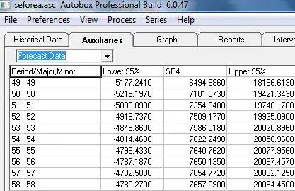

After being advised that the 48 values were MONTHLY.. A useful model was automatically constructed blending arima structure and any waiting-to-be-identified deterministic structure. The model is here enter image description here and here enter image description here with statistical summary here enter image description here.
The plot of the residuals is here enter image description here and forecast plot here enter image description here
The arima portion is very similar to my first response as it has both a lag 1 and a lag 3 component. enter image description here . (1,0,0)(1,0,0)3 .
One level shift down at or around period 20. Three pulses .. 14,23 and 4. Two seasonal dummy factors are also found representing a systematic downwards effect at period 1 and period 7 thus there is seasonality ( i.e. two seasonal dummies ) and not auto-projective seasonality i.e. arima seasonality.
Following is a table of forecasts enter image description here
The Actual/Fit and Forecast is here enter image description here
