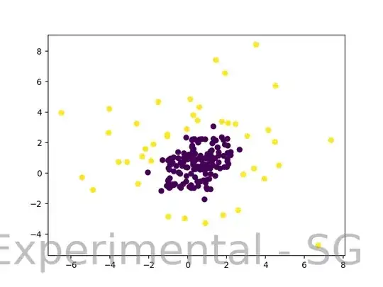

Since this was generated using 2 distributions, I wanted to see the clusters created by both K-Means and Expectation-Maximization. So I created and plotted them. Cluster using K-Means looks as follows:
The 2 clusters created from K-Means were somewhat expected. But the clusters created using Expectation Maximization were not close to what I had imagined it to be. It looks as follows:
I really feel that K-Means was able to capture more points from a particular distribution as compared to EM. Also, I had imagined that EM would be able to create overlapping clusters to distinguish the 2 square formations you see in the dataset plot. What is the intuition behind EM performing this way?

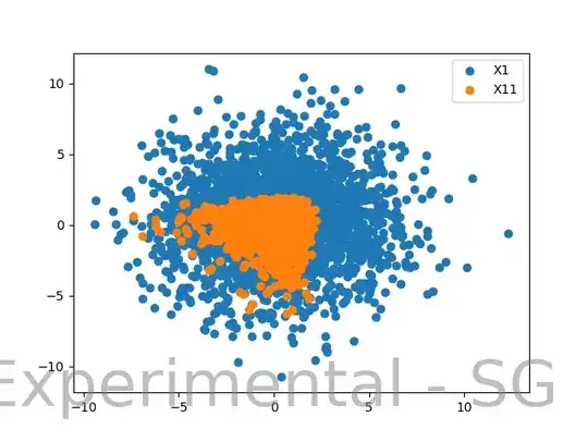

As I generated a lot more data samples, EM was able to give out clusters that were visually much more satisfying. What could be concluded from this? Here is the plot of dataset with much more samples. enter image description here
And the plot where EM created clusters:
Here K-Means just adds a linear separator, which was expected from K-Means on this dataset.
How do we explain the result here? Why was EM able to cluster data better with much more data samples?

What the K-means algorithm does is just to follow a recipe: alternate between computing the means of each of the K classes (centers of gravity) and assigning each point to the nearest mean. The outcome is such that only points which are close together are deemed to be in the same class.
A Gaussian mixture model, on the other hand, assumes that for each datapoint x_n there is a latent (hidden) variable z_n with values 1, ..., K representing its cluster (or class). Conditional on z_n, x_n is drawn from a Gaussian distribution with mean and co-variance matrix depending on the class z_n. The EM algorithm attempts to find the configuration of the z_n's that maximizes the overall likelihood.
In your example, you're generating data from a mixture of two distributions: orange and blue, so K=2. Orange and blue are not strictly Gaussian, but close enough. Accordingly, in both cases (even with only few data) the mixture model picks up that there is one distribution with a bigger variance (yellow) and one with a smaller variance (purple). By design, K-means has no chance of picking up this pattern.

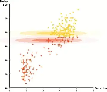

This is similar to the following image from Wikipedia:
Except that you want to look at the differences between the shaded intensities (the filled ellipses, not the individual points, redness minus yellowness). Also, the Wikipedia situation has well separated clusters, but in your case they overlap badly, which makes them pretty much inseparable. The visualization above aims at visualizing the lack of separability...
