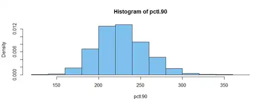

Because you are assuming limited computing power, I suppose you wouldn't be able to do this next step, but by taking a large number of samples of size 100 we could get an idea of the sampling distribution of their 90th percentiles.
pctl.90 = replicate(10000, quantile(sample(x,100),.9))
summary(pctl.90)
   Min. 1st Qu.  Median    Mean 3rd Qu.    Max.
  126.1   207.0   224.6   227.0   244.9   367.4
My initial half dozen runs gave a fairly good idea how successful estimating the 90th percentile of 100,000 observation by looking at a subsample of 100 is likely to be.
Note: There is a limit theorem that quantiles (except max and min) of large samples from continuous data, in regions where the density function is positive, tend to be normally distributed. So the histogram of pctl.90, although not exactly normal with $n = 100,$ suggests convergence to normal. (One reference: Bain & Englehardt (1992), Sect. 7.5.)
