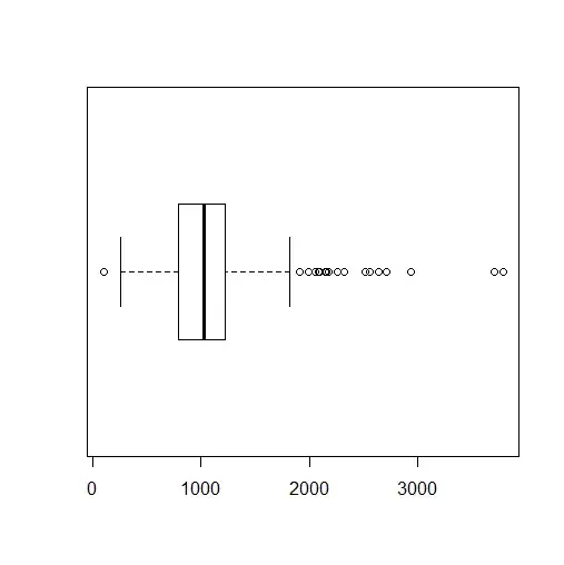

I think i need to work on the data first and then do forecasting. The boxplot of the series is shown as below.
My question is going forward how can i improve model performance to get better accuracy on test data. Do i need to pre-procees the series first and if yes what what should i look into.
