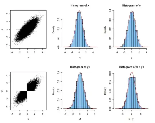

Comment (continued), illustrating the last sentence of my Comment above with a simulation.
For $X$ and $Y,$ let means be 0, SDs 1, and $\rho = 0.8.$ A sample of size 100,000 from their joint binomial distribution is simulated below in R. [See this page for the method of simulation.]
set.seed(923)
m = 10^5;  rho = .8; phi = sqrt(1-rho^2)
x = rnorm(m);  z = rnorm(m)
y = rho*x + phi*z
cor(x,y)
[1] 0.7997351  $ aprx 0.8
The bivariate normal distribution is suggested by the upper-right plot in the figure below. The two histograms in the top row suggest the standard normal marginal distributions.
Now, manipulate the results so that the marginals are unchanged, but the joint distribution is no longer bivariate normal, and the sum $T = X + Y_1$ is not normal.
y1 = y;
 y1[x < 0] = -abs(y[x < 0])
 y1[x >= 0] = abs(y[x >- 0])
cor(x,y1)
[1] 0.8546086  # > 0.8
Finally, what would happen if $Y_2 = -X?$ Then are $X$ and $Y_2$ bivariate normal? Is $X + Y_2$ normal?

  • I'm a little bit lost. So the only way to determine X+Y's distribution in my problem is to generate a bunch of values using the distribution as the generator and then plotting the results in a histogram? Also, even if both jointly normal distributions and non-jointly normal distributions can have normal marginals, I'm not sure how that relates to what I said in my post. I'm not trying to be rude and am very appreciative of your help, I'm just not really understanding it. – strwars Sep 23 '18 at 23:49
  • Not suggesting simulation as an alternative to understanding the theory. Just showing possibilities to try to get you to think clearly and productively. The two bullets in your Question are more complicated than may be immediately obvious. For the first part, maybe tomorrow you should give the link another chance. It is very well written. – BruceET Sep 24 '18 at 00:10
