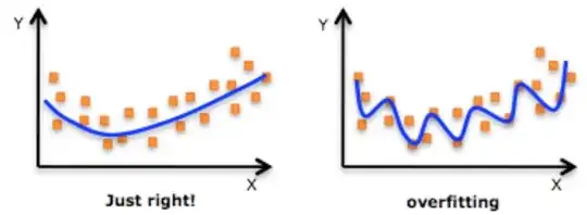

Overfitting is the state where an estimator has begun to learn the training set so well that it has started to model the noise in the training samples (besides all useful relationships).
For example, in the image below we can see how the blue on the right line has clearly overfit.
But why is this bad?
When attempting to evaluate our model on new, previously unseen data (i.e. validation/test set), the model's performance will be much worse than what we expect.

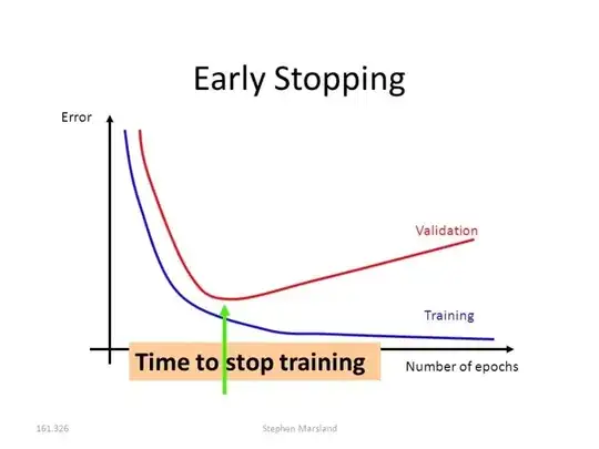

  • Early stopping. This technique attempts to stop an estimator's training phase prematurely, at the point where it has learned to extract all meaningful relationships from the data, before beginning to model its noise. This is done by monitoring the validation loss (or a validation metric of your choosing) and terminating the training phase when this metric stops improving. This way we give the estimator enough time to learn the useful information but not enough to learn from the noise.
    keras implementation.

  • As mentioned previously it also may be beneficial to stop your model earlier in the training phase than scheduled. The problem with early stopping is that there is no guarantee that, at any given point, the model won't start improving again. A more practical approach than early stopping is storing the weights of the model that achieve the best performance on the validation set. Be cautious, however, as this is not an unbiased estimate of the performance of your model (just better than the training set). You can also overfit on the validation set. More on that later.
