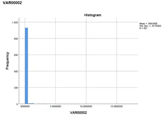

I need to detect and remove outliers in my data. Before doing that, I want to test if my data is normally distributed or not. I have two variables X(independent) and Y(dependent) and have 951 records for both of them.
I want to know that while testing the normality, do I need consider both the variables simultaneously or both the variables but one at a time? (Somewhere, I have read that only dependent variable is considered to test the normality).
The attached figures show the results of normality test (Analyse>>Descriptive >>Explore) of dependent variable. If normality test is done only on dependent variable, then it shows that the data is highly skewed. In such a case, how can I remove the outliers?The image shows histogram of dependent variable
The significance level of Shapiro-Wilk test and Kolmogorov-Smirnov test is 0.00. Skewness has statistic of 22.909 with SE of 0.079.
Ferdi

  • The histogram isn't very helpful beyond telling you about marked skewness. For example, are there values all the way up to 15 or so, but they are just rare? I can't see bars myself What are the minimum and maximum values? If the minimum is positive, I would certainly consider logarithmic transformation. Can you report at least minimum, median and quartiles and maximum? – Nick Cox Aug 31 '18 at 11:30

  • @Nick. Yes, I have seen them. But I was bothered about highly skewed variation in my dataset. That's why, posted the results to get the views. Regarding what you asked- the data distribution is like- there is only one value 17.06; 13 values between 1-4; 158 values - 0.01-1, 421 values - 0-0.01; 359 values of 0. Min=0, max=17.06, mean = 0.066, median = 0.0000387, IQ range = 0.0029 – Alexia k Boston Aug 31 '18 at 11:48

Finally, you show a histogram of your DV. The histogram is not a very useful plot (as William S. Cleveland notes in his books).
