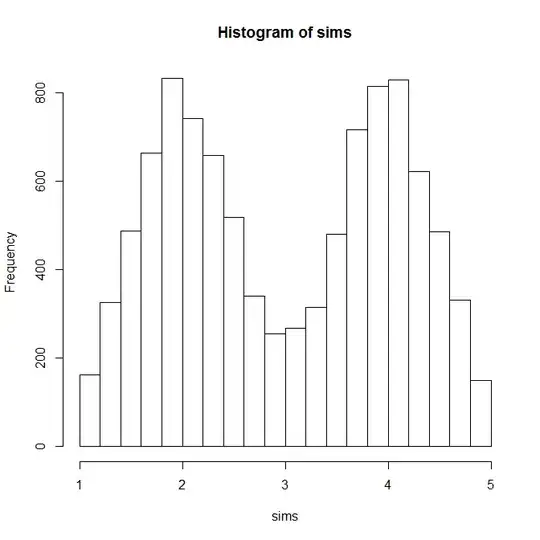

The easiest approach would be to draw $\frac{n}{2}$ samples from a truncated normal distribution with one mean and another $\frac{n}{2}$ samples from a truncated normal distribution with a different mean. This is a , specifically one with equal weights; you could also use different weights by varying the proportions by which you draw from both distributions.
library(truncnorm)
nn <- 1e4
set.seed(1)
sims <- c(rtruncnorm(nn/2, a=1, b=5, mean=2, sd=.5),
                    rtruncnorm(nn/2, a=1, b=5, mean=4, sd=.5))
hist(sims)
histogram
