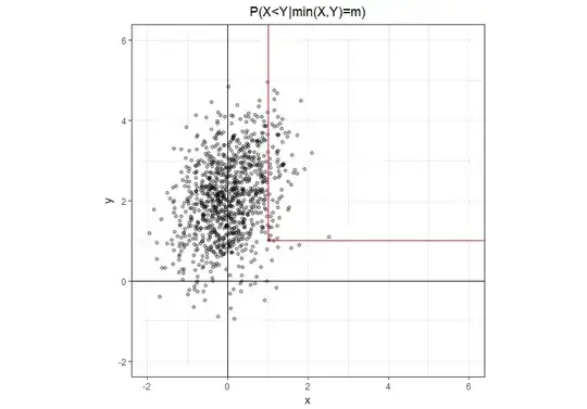

Using the slightly more explicit notation $P(X<Y|\min(X, Y)=m)$, where $m$ is a real number, not a random variable. The set on which $\min(X,Y) = m$ is an L shaped path with two half-open segments: one going straight up from the point $(m,m)$ and another going straight to the right from this same point. It's clear that on the vertical leg, $x<y$ and on the horizontal leg $x>y$.
mu1=0, mu2=2, sigma11=0.5, sigma22=1, sigma12=0.2, m=1
Given this geometric intuition its easy to rewrite the problem in an equivalent form, where in the numerator we have only the vertical leg where $x<y$ and in the denominator we have the sum of the two legs.
$P(X<Y|\min(X, Y)) = \frac{ \displaystyle P(m<Y|X=m) }{ \displaystyle P(m<Y|X=m) + P(m<X|Y=m) } \tag{1}$

Based on simulation code provided by the question author, we can compare this theoretical result to the simulated results:
