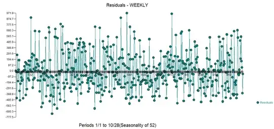

The residuals from the model suggest sufficiency enter image description here
