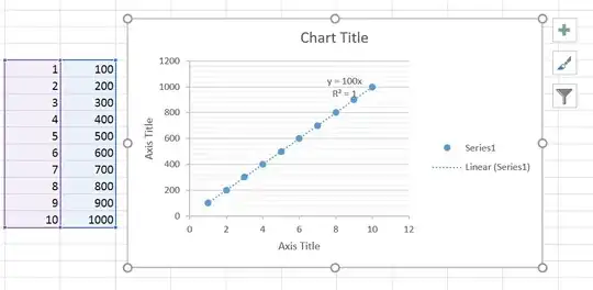

If I run a regression over my full data set in excel it provides a formula
y = 100x
or y= 100x +some other value if my example wasnt so simplistic
In this simplistic answer
If I have x = 20.
I would simply multiply 100 * 20 to give 2000.
My question is: In traditional regression calculations how do I obtain this slope formula that excel provides?
y=100X
is there a way to obtain this from my data?

Simple linear regression will suggest calculating
$$\hat\beta = \frac{ \sum\limits_{i=1}^n \left(x_i - \frac1n\sum\limits_{j=1}^n x_j\right)\left(y_i - \frac1n \sum\limits_{j=1}^n y_j \right) }{ \sum\limits_{i=1}^n \left(x_i - \frac1n\sum_{j=1}^n x_j\right)^2 }$$ $$\hat\alpha = \frac1n \sum\limits_{j=1}^n y_j - \hat\beta\,\frac1n\sum\limits_{j=1}^n x_j$$
and then the regression line
$$\hat y_i = \hat\alpha + \hat\beta x_i $$
which passes through the point $(\bar x, \bar y)$ with optimial slope, so as to minimise the sum of squares of residuals $\sum\limits_{i=1}^n (y_i-\hat y _i)^2$
With your example it will give $\hat\beta=100$ and $\hat\alpha=0$
