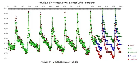

I took your 301 values into AUTOBOX a piece of software that I had helped to develop and I asked it to tell me what it could find out by studying the 301 historical values. It hesitated for a very brief amount of time and told me the following.
Here is the Actual /Fit and Forecast graph enter image description here
3: https://i.stack.imgur.com/lbD0m.png and a less busy Actual/Forecast enter image description here . The USEFUL equation that was found ( Note all models are "rong" but some are useful and some are very wrong ) is here in two parts. enter image description here and enter image description here providing clarity that the arima portion is simply (1,0,0) .
The statistics for the model are presented here enter image description here
The residuals look pristine enter image description here with a very clean acf enter image description here .
A closeup of the forecasts is here ....enter image description here

  • The data suggests that there is a systematic cycle of 43 periods where periods1-8 and 36-43 do not materially effect the observations i.e. they are not significant. However there appears to be a deterministic effect e.g. a Monday effect on daily dales for other periods in the cycle. This explains the saw-tooth appearance. This explains the saw-tooth phenomenon being "caused by an unspecified predictor" i.e an exogenous effect. ARIMA model treat all effects as endogenous while Intervention Detection leads to ARMAX models whose effects are latent and waiting to be discovered. – IrishStat Jul 03 '18 at 09:36
  • to put things in another light suppose your are analyzing daily sales and you find that tuesday's sales are always higher than any other day. After identifying the tuesday effect one would naturally be curious as to why? Upon research one might find that the owner of the store sets a lower price on Tuesday. IN tour case there is a background/unreported/exogenous series that is "causing" the effects . Note that it is not always a cycle of 43 but "close". Now that you have identified the presence of another variable,you might want to pursue "it" and use it to aid the prediction of your series, – IrishStat Jul 03 '18 at 12:16
