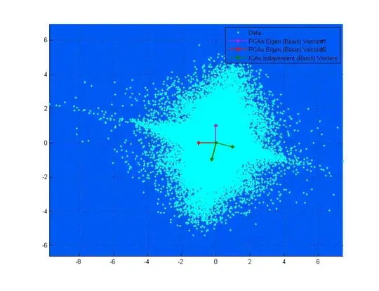

The top diagram above can help you visualize it. You can clearly see how the ICA vectors correspond to the axes of the data, (independent of each other), whereas the PCA vectors try to find directions where variance is maximized. (Somewhat like resultant).
If in the top diagram the PCA vectors look like they almost correspond to the ICA vectors, that is just coincidental. Here is another instance on different data and mixing matrix where they are very different. ;-)

    Seeems that you're familiar with both of the methods. As a competent person, can you answer if those methods inherently imply that the basis vectors are orthogonal? How could one discover the primary or independent components that have a non-zero projection on each other, something like two point clouds oriented approximately at 45 degree angle to each other? – mbaitoff Sep 12 '13 at 07:52
    @mbaitoff ICA will recover an orthogonal basis set of vectors, yes. Secondly, when you have as you are asking, two signals that have a non-zero projection on each other - that is exactly what ICA is trying to undo. That is why the final basis vectors found by ICA are orthogonal to each other. Then when you project your data on those two new vectors, they are going to be orthogonal to each other. – Spacey Sep 12 '13 at 20:10
    @Tarantula I have asked a question about what I'm talking: http://stats.stackexchange.com/questions/6575/how-to-do-primary-component-analysis-on-multi-mode-data-with-non-orthogonal-prim , you can see the illustration, http://i.stack.imgur.com/U6fWb.png . I cannot understand how an orthogonal basis would describe those two clouds. It's obvious for me that two vectors describing the major oscillation directions are not orthogonal. – mbaitoff Sep 13 '13 at 03:27
  • @mbaitoff You took your data from two sensors, and you plot them against each other, and you see those two modes, so you know they are at least correlated. Then the question becomes, how can you project all the points you have there, such that they are independent? (ie, on an orthogonal basis like what ICA finds). That is what ICA finds for you. I dont understand what you mean when you say "I cannot understand how an orthogonal basis would describe those two clouds.". Why not? – Spacey Sep 13 '13 at 05:11
  • @Tarantula Oh, now I see what that means! I thought it was like 'finding two orthogonal vectors on original plot' while indeed it means 'finding two vectors on original plot a projection on which will make them orthogonal (independent)'. – mbaitoff Sep 13 '13 at 05:19
  • @mbaitoff Yes exactly. – Spacey Sep 13 '13 at 05:32
