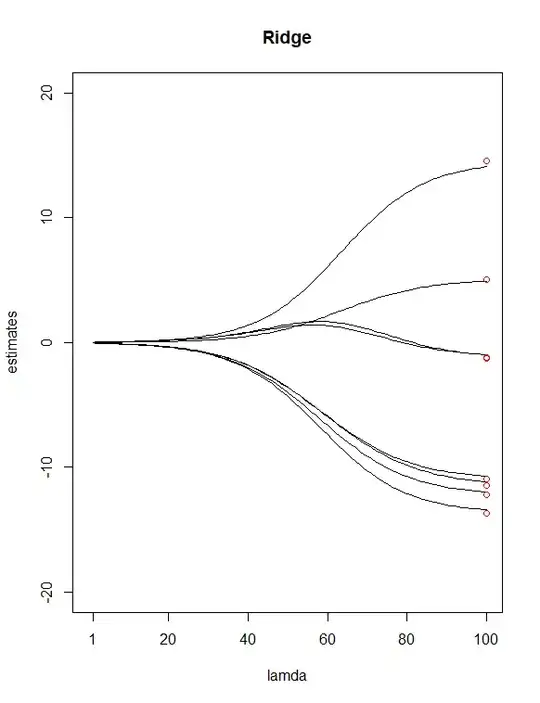

Simply by looking at P-values from the $summary()$ table, I have picked $age100$ and $can$ as potential 'less important' predictors. I then used $glmnet()$ to fit a ridge regression and lasso regression of Y with all my X's, allow the function to choose a $\lambda$ value for me. I then plotted the two regressions, with 100 $\lambda$ values for ridge and 65 $\lambda$ values for lasso. Finally, add points lying above index 100 and 65 drawn at vertical values equal to the 8 least squares estimates of the coefficients(in red).
Resulting in the above two plots, some differences that I spotted were
It seems reasonable to me that Lasso eliminated two variables($age100$ and $can$) which it appears to agree with my previous assumption of having these two predictors as 'less important' ones. Notice in the ridge plot, the first and roughly third estimates points are off from the line. However in the lass plot, points are right on those lines. Does this indicate improvement of my predictor reduction from ridge to lasso? (A.K.A, 6 predictors model does a better job in fitting the data than 8 predictors model?)

  • Regarding your two additional questions the interpretation of the plots and the parameter $\lambda$ you should find answer's elsewhere on this website. 1) answer is 'yes' without penalty ($\lambda=0$) you get just the OLS estimate 2) the plots are the estimated coefficients as function of the parameter $\lambda$ (apparently that, 'lamda' or 'lambda', is what is written but I guess that this is wrong, it seems like the x-axis is the norm or something). Regarding interpretation. 1thing: for the Lasso you should note the increase in number of non-zero components as the x-axis parameter increases. – Sextus Empiricus May 27 '18 at 13:09
  • For more specification of the second additional question you should better tell how those graphs have been made (the code), as well as what kind of interpretation you are looking for. – Sextus Empiricus May 27 '18 at 13:11

Each trajectory shows the value of an individual coefficient as $\lambda$ is changed. It looks like your x axis is mislabeled ($\lambda$ is actually decreasing from left to right).
Some general things you can notice in these plots (which are well known facts about lasso and ridge regression): Both methods shrink the coefficients more strongly toward zero as $\lambda$ increases (moving from right to left on the x axis). Lasso produces sparse solutions--as $\lambda$ increases, more and more coefficients are driven exactly to zero while others remain relatively large (which is why lasso is useful for variable selection). Ridge regression doesn't behave this way--as $\lambda$ increases, the overall magnitude of the coefficients decreases, but individual coefficients are not driven exactly to zero.
what does it mean for the ending points in red on the line or above or below
You said the red points represent the OLS coefficients. Because lasso and ridge regression shrink the coefficients toward zero, the magnitudes will be smaller than OLS when $\lambda > 0$. Your plots would intersect the red points at $\lambda=0$, where all methods are equivalent.
