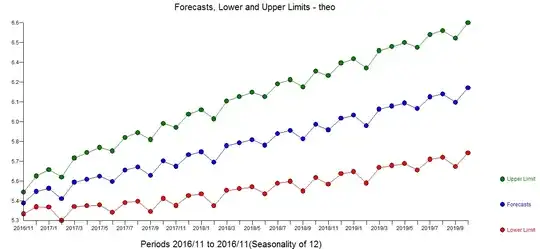

The forecasts are detailed here enter image description here .
