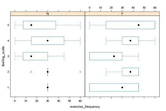

Try the lattice package and maybe box-and-whisker plots.
# Make up some data
set.seed(1)
test = data.frame(feeling_scale = sample(1:5, 50, replace=TRUE),
                  smokes = sample(c("Y", "N"), 50, replace=TRUE),
                  exercise_frequency = sample(seq(0, 60, 15),
                                              50, replace = TRUE))
library(lattice)
bwplot(exercise_frequency ~ feeling_scale | smokes, test)

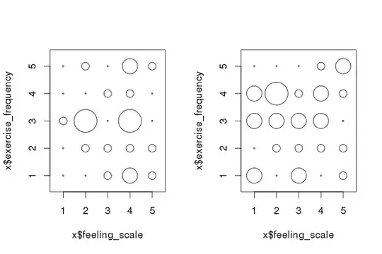

A third option I can think of is the bubble plot, but I'll leave it up to you to decide on how to scale the circles appropriately. It also requires that you first get the frequencies of the different combinations of exercise_frequency and feeling_scale.
test2 = data.frame(with(test,
                        table(feeling_scale,
                              exercise_frequency, smokes)))
par(mfrow = c(1, 2))
lapply(split(test2, test2$smokes),
       function(x) symbols(x$feeling_scale, x$exercise_frequency,
                           circles = x$Freq, inches=1/4))
