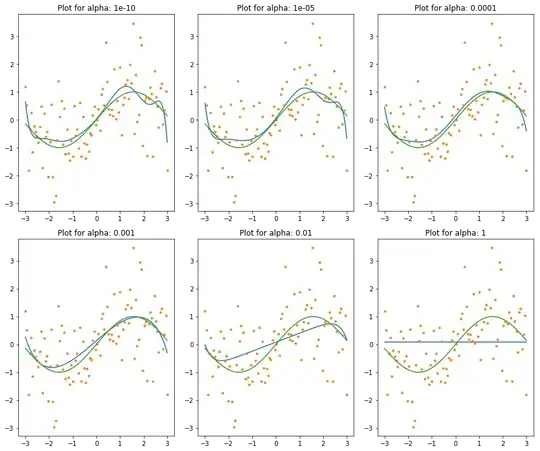

Great, but the problem is that we usually deal with noisy data. Look at what happens if you fit the same to 100 observations of very noisy data, see the chart below. We're back to square one: higher order polynomials produce horrible oscillating fits. So, increasing data set didn't help that much in increasing the complexity of the model to better explain the data. This is, again, because complex model is fitting better not only to the shape of the signal, but to the shape of the noise too.
Finally, let's try some lame regularization on this problem. The chart below shows regularization (with different penalties) applied to order 9 polynomial regression. Compare this to order (power) 9 polynomial fit above: at an appropriate level of regularization it is possible to fit higher order polynomials to noisy data.
Just in case it wasn't clear: I'm not suggesting to use polynomial regression this way. Polynomials are good for local fits, so a piece-wise polynomial can be a good choice. To fit the entire domain with them is often a bad idea, because they are sensitive to noise, indeed, as it should be evident from plots above. Whether the noise is numerical or from some other source is not that important in this context. the noise is noise, and polynomials will react to it passionately.

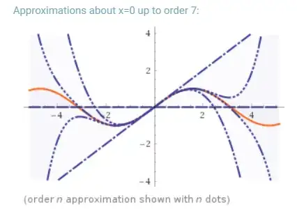

  • I don't understand "Consider a Taylor approximation, more terms is always better for non-polynomial function (ignoring numerical precision issues)". Isn't it the case that Taylor series approximations even when well-defined aren't guaranteed to converge, and even when convergent, may not converge to the function being approximated? Do these issues fall under numerical precision? – RoryT May 14 '18 at 11:37
  • @RoryT yes numerical issues are the most serious in absence of noise with Taylor series provided that they are well defined. Once you get to high powers the low digits are quickly lost and precision is gone, wild artificial oscillations will kick in. – Aksakal May 14 '18 at 11:45

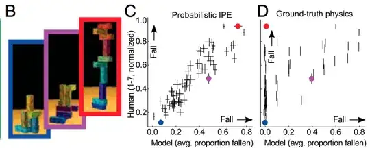

To illustrate the difference in generalization power of models represented as actual programs vs deep learning models, I'll show the one in this paper: Simulation as an engine of physical scene understanding.
(A) The IPE [intuitive physics engine] model takes inputs (e.g., perception, language, memory, imagery, etc.) that instantiate a distribution over scenes (1), then simulates the effects of physics on the distribution (2), and then aggregates the results for output to other sensorimotor and cognitive faculties (3)
(B) Exp. 1 (Will it fall?) tower stimuli. The tower with the red border is actually delicately balanced, and the other two are the same height, but the blue-bordered one is judged much less likely to fall by the model and people.
(C) Probabilistic IPE model (x axis) vs. human judgment averages (y axis) in Exp. 1. See Fig. S3 for correlations for other values of σ and ϕ. Each point represents one tower (with SEM), and the three colored circles correspond to the three towers in B.
(D) Ground truth (nonprobabilistic) vs. human judgments (Exp. 1). Because it does not represent uncertainty, it cannot capture people’s judgments for a number of our stimuli, such as the red-bordered tower in B. (Note that these cases may be rare in natural scenes, where configurations tend to be more clearly stable or unstable and the IPE would be expected to correlate better with ground truth than it does on our stimuli.)
My point here is that the fit in C is really good, because the model captures the right biases about how humans make physical judgments. This is in big part because it models actual physics (remember that it is a actual physics engine) and can deal with uncertainty.
Now the obvious question is: can you do that with deep learning? This is what Lerer et al did in this work: Learning Physical Intuition of Block Towers by Example
Their model: enter image description here
Their model is actually pretty good on the task at hand (predicting the number of falling blocks, and even their falling direction)
