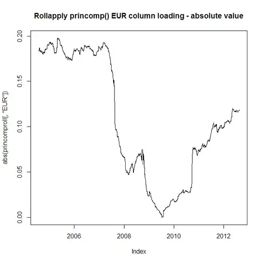

I have 10 years of daily returns data for 28 different currencies. I wish to extract the first principal component, but rather than operate PCA on the whole 10 years, I want to rollapply a 2 year window, because the currencies' behaviours evolve and so I wish to reflect this. However I have a major problem, that is that both the princomp() and prcomp() functions will often jump from positive to negative loadings in adjacent PCA analyses (ie 1 day apart). Have a look at the loading chart for the EUR currency:
Clearly I can't use this because adjacent loadings will jump from positive to negative, so my series which uses them will be erroneous. Now take a look at the absolute value of the EUR currency loading:
The problem is of course that I still cannot use this because you can see from the top chart that the loading does go from negative to positive and back at times, a characteristic which I need to preserve.
Is there any way I can get around this problem? Can I force the eigenvector orientation to always be the same in adjacent PCAs?

    Could you explain what you mean by eigenvector "orientation"? As far as I know, there is no such thing that is intrinsic to the data. (That's one reason why different software will produce different normalized eigenvectors.) So it sounds like you're asking for something that does not exist and is meaningless. – whuber Aug 15 '12 at 20:20
    Well on one day I'll get loadings like this: EUR -0.2 ZAR +0.8 USD +0.41 ..... 28 currencies. And the next day I'll get EUR +0.21 ZAR -0.79 USD -0.4 etc. So the axis that the PCA has chosen to rotate the data onto is oriented exactly the opposite way on day 2, compared with day 1. That is causing these loading jumps and I wish to avoid it, somehow......Apologies if my terminology is misleading. I understand that the PCA code doesn't really care about the axis orientation as long as it is consistent across loadings on one day, but I need it to be consistent across multiple days. – Thomas Browne Aug 15 '12 at 20:23
    keeping in mind that from one day to the next, given a rolling 2 year window on daily data, we should have very, very similar PCA. – Thomas Browne Aug 15 '12 at 20:26
  • I think the reason that you have a problem is that this rollapply idea doesn't make sense. I have no solution other than to look for something different that may achieve your goals (not sure what they are) and is sensible. – Michael R. Chernick Aug 15 '12 at 20:38
  • EUR -0.2 ZAR +0.8 USD +0.41 and EUR +0.21 ZAR -0.79 USD -0.4 are very very similar. You simply invert sign in any of the two results. – ttnphns Aug 15 '12 at 20:46
  • Why does it not make sense that the euro, a currency which tended to be strong in periods of risk aversion, now tends to be weak in the same periods of risk aversion? We have gone through a major financial crisis, and the behaviour of some currencies is now different from how they operated pre-crisis. A 10y PCA will clearly not identify this change of behaviour whereas a 2y rolling window clearly does. I could identify this change using rolling correlations on the first PC but I would probably get a much weaker first PC anyway and so this rolling PCA technique I think is superior? – Thomas Browne Aug 16 '12 at 08:56
  • I think, a basic requirement to get the rolled eigenvectors in a common vectorspace ("can I force the eigenvectors...same orientation") should be a common measuring over all samplings. That means in my opinion, you should assume ratio scale for your measurings and prevent the rolling factor-analyses to re-center and re-scale the current sub-sample ( so this means also to use a rolling covariance matrix instead of a correlation matrix besides the preventing to recentering around the dynamical means). Did you consider this? – Gottfried Helms Aug 16 '12 at 09:01
  • @ Gottfried Helms: Gottfried, the above graphs do use a rolling covariance matrix as that is the default for the princomp function (cor = FALSE). Moreover I have already scaled the variables because as you will note, I am using "EUR" only, not "EURUSD" or some other crossrate price, because I have created variance and scale normalised indices for each currency themselves derived from PCA. So yes, all my samples across currencies use a common and comparable scaling in both magnitude and variance. Is that what you meant? – Thomas Browne Aug 16 '12 at 10:30
26
Whenever the plot jumps too much, reverse the orientation. One effective criterion is this: compute the total amount of jumps on all the components. Compute the total amount of jumps if the next eigenvector is negated. If the latter is less, negate the next eigenvector.
