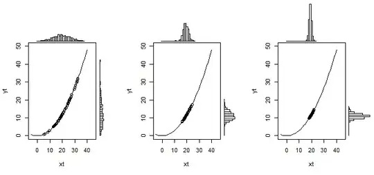

The image below might illustrate this intuitively:
intuitive Delta method
In this example $Y=0.03 X^2$. And $X \sim N(20, \sigma)$ is normal distributed with $\sigma$ changing from $36$ to $4$ and $1$. Simulations are made for 600 data points to create the histograms (60 points are used to plot on top of the curve in the graph). In the image on the left, when $X$ has a wide distribution, you see that the distribution of $Y$ is not well approximated with a linear transformation (it is a bit skewed), but as the variance of $X$ decreases (the images on the right) then the distribution starts to resemble more and more a normal distribution.
So that is what the linear transformation does in the Delta method. But when the slope is zero then this linearization doesn't work and you need to use a second order approximation of the curve. This is illustrated below
second order case
