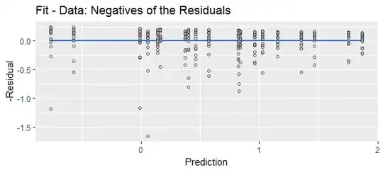

If instead we compute the difference in the other order, $\hat y - y,$ this will shift and then reverse the shape of the conditional distribution. Its skewness will be the negative of the original conditional distribution.
Figure 3: the previous plot with residuals negated
This shows the same quantities as the previous figure, but the residuals have been computed by subtracting the data from their fits--which of course is the same as negating the previous residuals.
Although both the preceding figures are mathematically equivalent in every respect--one is converted into the other simply by flipping the points across the blue horizon--one of them bears a much more direct visual relationship to the original plot.
Consequently, if our goal is to relate distributional characteristics of the residuals to the characteristics of the original data--and that almost always is the case--then it is better simply to shift the responses rather than to shift and reverse them.
The right answer is clear: compute your residuals as $y - \hat y.$
