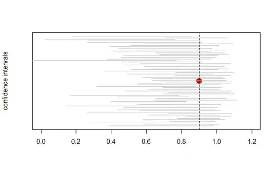

Here is a plot of the confidence intervals for 60 draws from the underlying AR process, showing that these sometimes lie "too far to the left."
R code:
plot(ar.coeff,0, cex=2, col="red", pch=19, xlim=c(0,1.2), ylab="confidence intervals", yaxt='n', xlab="")
segs <- 60
segments(CI[1:segs,1],seq(-1,1,length.out = segs),CI[1:segs,2],seq(-1,1,length.out = segs), col="grey")
abline(v=ar.coeff, lty=2)

  • confint does precisely that. You are right in that my example only refers to bias in the coefficient estimates and not in the s.e.s, but as the example shows, that is sufficient to exhibit undercoverage of the CIs. – Christoph Hanck Apr 27 '18 at 05:34
