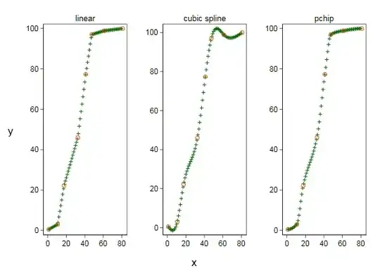

I'd suggest not thinking of curve fitting, but of interpolation. Here are three methods of interpolation: linear (familiar since childhood), cubic spline and piecewise cubic Hermite. The aspect ratios for the graphs exaggerate the differences, which is needed for comparison. Cubic spline in particular waggles locally but pchip respects local maxima and minima and thus is monotonic for these data. (If you have subject-specific knowledge on whether the relationship should be monotonic, do tell.)
To do the interpolation I added a grid at $x =$ 1(1)80.
For $x =$ 50 I get
  |    linear      spline       pchip |
  | 97.351225   100.56174   97.639561 |

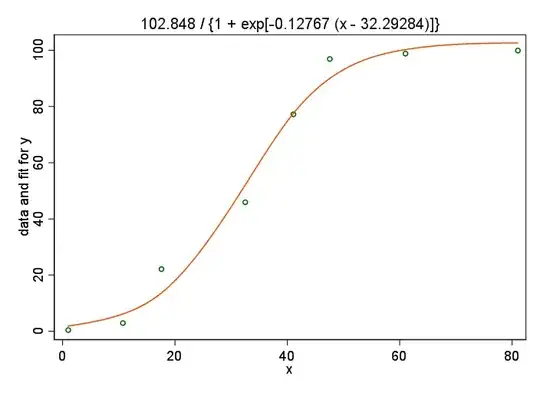

and a logistic equation
The latter predicts 93.12383 at $x =$ 50. The polynomials show the usual sad progression from underfitting to overfitting. What extra spin the logistic may deserve from relevance to underlying process I can't say. There might be a case for taking 100 as known upper limit and leaving only two parameters to estimate.

    +1. But in light of the additional information--that the curve should be monotonically increasing from (0,0) to (100,100)--one would be tempted to fit a GLM using something like a Beta CDF link (two parameters only). The logistic regression at least is the likeliest, out of the options you offer, to indicate the magnitude of the errors. The utility of this exercise is somewhat doubtful, unless the "prediction" is intended as a retrodiction: before the end of the season, how is one to know the total accumulated rainfall? – whuber Apr 20 '18 at 13:36
    @whuber Indeed. I have a climatologist persona but left that on one side. My last sentence is key here. If the OP had revealed all in the question at the outset I would have treated 100 as a known constant. It's fairly reassuring that the model comes up with 103 or so as an estimate, but we can still do better. I learned from my namesake Sir David Cox years ago that good models always respect known limiting behaviour. – Nick Cox Apr 20 '18 at 13:52

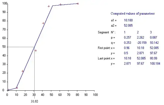

The fitting to a linear piecewise function might be sufficient to model your experiment. The figure below shows the result of fitting a three segments piecewise function to your data.
The equation of the function is :
The computed values of the parameters $a_1 , a_2 , p_1 , q_1 , p_2 , q_2 , p_3 , q_3 $ are shown on the figure.
The method of calculus is very simple (no iteration, no initial guessed value). See pages 30 and 31 in the paper : https://fr.scribd.com/document/380941024/Regression-par-morceaux-Piecewise-Regression-pdf
If you want the value of $x$ corresponding to a given value $y$ on the second segment : $$x=\frac{y-q_2}{p_2}$$ For example with $y=50$ we get $x=\frac{50-(-20.159)}{2.262}=31.02$
The logistic equation found by Nick Cox leads to $x=31.86$ which is close (difference = $0.84$).
On the other hand, at $x=50$ the piecewise function gives $y=2.262*50-20.159=92.94$
The N.Cox's logistic function gives $y=93.14$ very close again (difference = $0.20$)
On a statistical viewpoint, the logistic model might be more significant that the piecewise model. So, one could prefer the logistic model, even if the regression for fitting is more complicated than with the piecewise model.
    I think on biological grounds one expects continuous growth and thus smooth change here. Thus this form is implausible in principle for all that in practice it gives similar predictions. With 8 parameters to be estimated it is not parsimonious! I also underline a point made elsewhere: the upper limit of 100% should be regarded as a known constant; that wasn't apparent in the question as first posted. The particular data example is not only just one example; it is too small to justify fine judgments about which method is best. – Nick Cox Jul 02 '18 at 17:36
  • @Nick It appears that the function is intended at least to be continuous, thereby making it a linear spline with "only" six rather than eight parameters. However, given that this is a cumulative function, fitting via least squares (as hinted at by the reference to "method of calculus") is inappropriate: the responses surely are strongly correlated and heteroscedastic. The latter considerations apply to any proposed solution, btw. – whuber Jul 02 '18 at 17:47
  • In retrospect I would delete "continuous growth and thus". – Nick Cox Jul 02 '18 at 17:56
  • @Nick Cox. Of course, that is what I pointed out in the last sentence of my answer. The aim of my answer is not to propose a physical model. It is a purely computational tool which can compute numerical results close to a physical model, but on a simpler way (without iterative process and without initial guess). That is a answer to Crop89's question of numerical calculus, without discussion about the physical model. The proposed piecewise function is not a physical model, it is a mathematical approximate of a physical model (which, by the way, is not clearly known). – JJacquelin Jul 02 '18 at 18:26
  • Glad we agree broadly, but you didn't give any reason why a logistic might be preferred. Very minor point: "physical model" is indelicate wording when it's biology! A more serious point is that you can keep the same attitude and make the procedure simpler yet by resorting to linear interpolation. – Nick Cox Jul 02 '18 at 18:34
