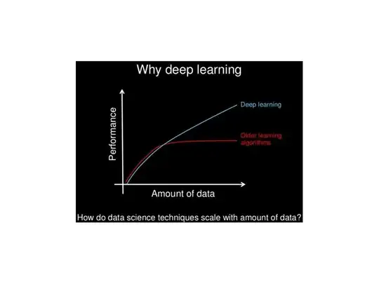

Here's a theoretical graphic of performance vs amount of data for which I've lost the reference:
enter image description here There are some CV threads with related discussions, e.g.:
Reference showing that only deep learning algorithms benefit from using huge datasets
Fitting multilevel categorical variables with neural nets
