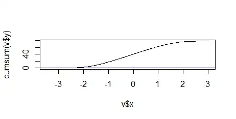

I consider the kernel density estimation, and I want to find the quantile the quantile at some level (0.95) of the KDE.
z<-rnorm(25)
v<-density(z)
plot(v$x,v$y,type="l")
qt<-quantile(z,0.997)
abline(v=qt,col="red")
plot(v$x,cumsum(v$y),type="l")
abline(h=0.997,col="blue",type="p")
The first plot is the plot of the KDE and the line of the quantile of the data. How to get the distribution of the KDE?
How to get the quantile with respect to the KDE? Is only for comparison. enter image description here

    The answer to this question was given in answer to your previous question. Densities do not sum to 1, they integrate to 1 – Tim Apr 17 '18 at 10:49
  • Yes, but How I construct the distribution starting from the density? – Boris Apr 17 '18 at 10:54

The cdf corresponding to the kernel density estimate $\hat f(x)$ is given by $$ \hat F(x)=\int_{-\infty}^x \hat f(u)du = \frac1n\sum_{i=1}^n \phi(\frac{x-x_i}h) $$ where $h$ is the bandwidth and $\phi$ is the cdf of the kernel used (e.g. the cdf of the standard normal). So equating this to $\alpha$ and solving for $x$ (numerically using some root finding algorithm) gives you the corresponding estimate of the $\alpha$-quantile (red line below), slightly larger than the empirical quantile (blue line).
