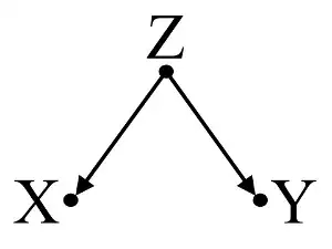

First, consider a simple example of confounder bias:
confounder
Here, a simple bivariable regression will suggest a dependence between $X$ and $Y$. However, there is no direct causal relationship between $X$ and $Y$. Instead, both are directly caused by $Z$, and in the simple bivariable regression, observing $Z$ induces a dependency between $X$ and $Y$, resulting in bias by confounding. However, a multivariable regression conditioning on $Z$ will remove the bias and suggest no dependence between $X$ and $Y$.

Confounder example: $X$ and $Y$ are dependent in bivariable regression and independent in multivariable regression conditioning on confounder $Z$.

The results of your analysis are not compatible with the confounder example but are compatible with both the collider example and the incidental cancellation example. Thus, a potential explanation is that you have incorrectly conditioned on a collider variable in your multivariable regression and have induced an association between $X$ and $Y$ even though $X$ is not a cause of $Y$ and $Y$ is not a cause of $X$. Alternatively, you might have correctly conditioned on a confounder in your multivariable regression that was incidentally cancelling out the true effect of $X$ on $Y$ in your bivariable regression.
