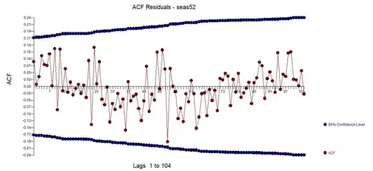

The plot of the residuals (always a good idea ! ) suggests sufficiency enter image description here . The plot of the acf of the residuals suggests a hint of an omitted (non-significant) ar(52) effect . enter image description here
