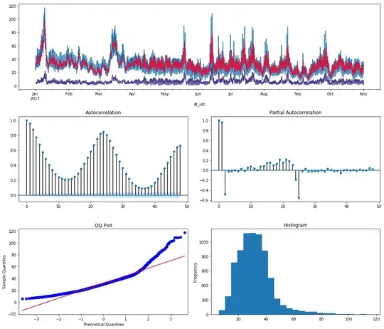

I fit a statsmodels.tsa.statespace.sarimax.SARIMAX model (statsmodels==0.8.0) but I'm getting unexpected forecasting behavior, in which the forecast has a negative slope (see last plot at the bottom).
Below are my endogenous and exogenous data, which have hourly sampling frequency. The endogenous variable appears to have 24 hour season.
Below is a time series diagnostic plot of the endogenous data. In the top figure, the red line is the rolling mean and the purple line is the rolling std:
After applying a season difference and first difference (e.g. using pandas, endog.diff(24).diff().dropna() I get a diagnostic plot like:
Which lead me to believe SARIMAX(0,1,0)(1,1,1,24) might be appropriate. This is the code I used to instantiate and fit the model:

After fitting the SARIMAX model, I did another diagnostic plot on the residuals:
I believe the data looks mostly stationary. There appears to be some seasonal correlations still, but I'm not sure how to get rid of that.

You are specifying an I(2) process, so you're specifying that the change in the time series is itself integrated. The forecast for the change of the series is then like a random walk (i.e. it won't die out). This estimate of this change (and so the forecast going forward) is encapsulated by the last estimated state (i.e. when the model is cast in state space form).
Because the change of the series is fixed (either positive or negative depending on the last estimated states), the forecast will trend up or down, regardless of the AR and MA coefficients.
Since the model is seasonal, there will also be a seasonal pattern, but the same general explanation applies to a non-seasonal ARIMA model with d=2.
It seems like you don't need seasonal differencing here - have you considered SARIMAX(0,1,0)(1,0,1,24)?

  • Hi @cfulton, I tried SARIMAX(0,1,0)(1,0,1,24) in the "First difference test" notebook I added (see cell In [6]), but the problem remains. The first difference ACF and PACF plots in In [4] made me think SARIMAX(1,1,0)(1,0,0,24) might be appropriate, but the prediction plot in Out[8] shows that the forecast quickly attenuates. – trianta2 Apr 05 '18 at 21:44
  • Actually, sorry, I think eliminating the non-seasonal differencing is better. I'm getting pretty reasonable results with SARIMAX(1, 0, 0)(1, 1, 1, 24) – cfulton Apr 07 '18 at 02:09
  • Indeed, SARIMAX(1, 0, 0)(1, 1, 1, 24) appears to work nicely and has removed the downward slope. Thanks! – trianta2 Apr 10 '18 at 15:55
