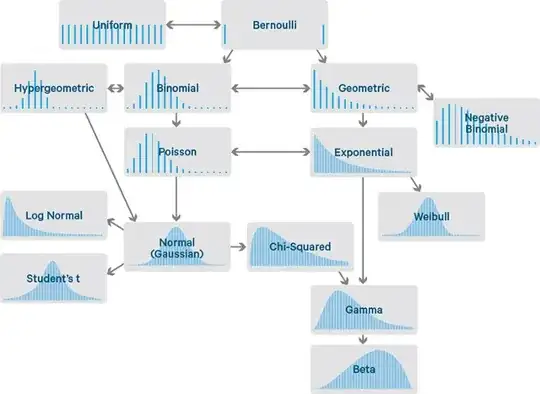

Some common probability distributions
Some common probability distributions; From here

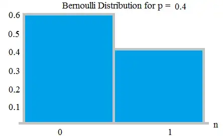

Bernauli Bernauli Distribution with probabilities 0.6 and 0.4; from here
