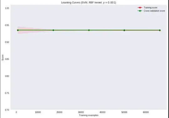

I have a training data size of about 80k.
I plotted a learning curve to check how much of the training sample is required to train the model. Although, after plotting my learning curve looks like this:

1) What is can I infer from this graph? Is it normal to have the curves overlap each other?
2) What should I understand from this particular graph?
Edit: As suggested I have started the iteration from training sample of 0 - len(data).
Although the lines still overlap.
- I failed to mention that the data is highly skewed. 80-20 imbalance. So I am guessing the model just predicts everything to be the majority class and that is the reason the scores are high. I am not sure. Any suggestions?

It is no surprise that the learning curve highly depends on the capabilities of the learner and on the structure of the data set and prediction power of its features.
It might be the case that there is only little variance in the combination of feature values (predictors) and labels (response). In this case even a small sample size can allow a capable learner to find all detectable patterns, resulting in a early high score. If not all patters can be detected, no perfect score can be achieved.
Since the training score is slightly above the cv-score for 10000 samples, I'd expect that there is an even greater difference for less than 10000 samples. So I suggest to test that. If the the overlap and score remains (even for a small number of examples, let's say << 1000), you should double check for an error (e.g. accidental row duplication, error in cv calculation (if you have done it yourself)).
Edit regarding class imbalance
The class distribution is
y
0    77623
1     5436
so guessing the majority class leads to an score of ~ 0.935, which is exactly what we see in the learning curve. The scoring function used in the learning curve is one provided by the estimator, which is Accuracy in case of SVC (see SVC documentation). The scoring function can be changed in learning curve (search for "scoring" in the learning_curve documentation, also needed to pass the parameter via plot_learning_curve).

leads to this graph
so there might be a code issue, maybe at initial loading / preprocessing of X and y.

  • I did fail to mention one important point in the question. My data is highly skewed. 80%-20% balance. I am guessing this is the reason why the learning curve is not making much sense because even it is predicts everything to be of the majority class - the scores are quite high. Am I right? – RPT Mar 12 '18 at 19:52
I would agree that at the first glance, there is no over-fitting and under-fitting.
One possibility is the learning task is easy and the model did an excellent job.
Think about the linear regression case. Suppose both training and testing data is generated from
$$y=\beta^Tx+\epsilon$$
So, both set will have the same distribution, and we cannot achieve 100% "accuracy" (RMSE in regression case), because of the irreducible error.
