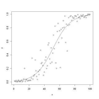

Now it's time for an implementation. There is an example of R code that evaluates such a model.
set.seed(1)
data = data.frame(x=1:100)
data$y = 1 / (1 + exp(5-0.1*(data$x) + rnorm(100)))
model = glm(y~x, family = 'binomial', data=data)
summary(model)
plot(x, y)
lines(x, predict(model, data, type = 'response'))
It outputs the following table of estimated coefficients (close to the "true" coefficients I used)
Coefficients:
            Estimate Std. Error z value Pr(>|z|)
(Intercept) -4.48814    0.88243  -5.086 3.65e-07 ***
x            0.08713    0.01615   5.394 6.89e-08 ***
and a picture with the training data and the fitted function
