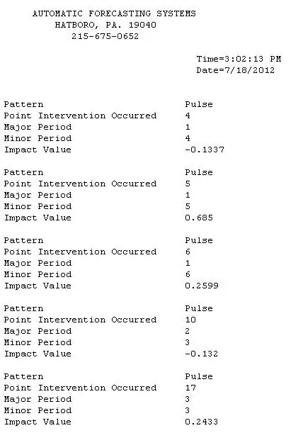

Upon identifying an arma model of the form $(1,1,0)(0,0,0)$ and a number of outliers the acf of the residuals indicates randomness since the acf values are very small. AUTOBOX identified a number of outliers:
The final model:
included the need for a variance stabilization augmentation a la TSAY where variance changes in the residuals were identified and incorporated. The problem that you had with your automatic run was that the procedure you were using, like an accountant, believes the data rather than challenging the data via Intervention Detection (a.k.a., Outlier Detection). I have posted a complete analysis here.
