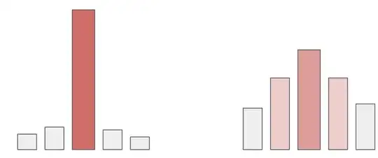

You would want to use a flexible formulation that would capture non-linearity automatically, e.g., some version of a generalized additive model. A poor man's choice is a polynomial $x_k$, $x_k^2$, ..., $x_k^{p_k}$, but such polynomials produce terrible overswings at the ends of the range of their respective variables. A much better formulation would be to use (cubic) B-splines (see a random intro note from the first page of Google here, and a good book, here). B-splines are a sequence of local humps:
http://ars.sciencedirect.com/content/image/1-s2.0-S0169743911002292-gr2.jpg
The height of the humps is determined from your (linear, logistic, other GLM) regression, as the function you are fitting is simply
$$ \theta = \beta_0 + \sum_{k=1}^K \beta_k B\Bigl( \frac{x-x_k}{h_k} \Bigr) $$
for the specified functional form of your hump $B(\cdot)$. By far the most popular version is a bell-shaped smooth cubic spline:
$$ B(z) = \left\{ \begin{array}{ll} \frac14 (z+2)^3, & -2 \le z \le -1 \\ \frac14 (3|x|^3 - 6x^2 +4 ), & -1 < x < 1 \\ \frac14 (2-x)^3, & 1 \le x \le 2 \\ 0, & \mbox{otherwise} \end{array} \right. $$
On the implementation side, all you need to do is to set up 3-5-10-whatever number of knots $x_k$ would be reasonable for your application and create the corresponding 3-5-10-whatever variables in the data set with the values of $B\Bigl( \frac{x-x_k}{h_k} \Bigr) $. Typically, a simple grid of values is chosen, with $h_k$ being twice the mesh size of the grid, so that at each point, there are two overlapping B-splines, as in the above plot.
