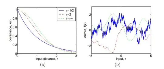

Furthermore, a Gaussian process with the Matérn covariance function with parameter $\nu$ is $\lceil \nu \rceil -1$-time differentiable .
This is quite nicely demonstrated on a picture taken from Rasmussen & Williams (2006) C. E. Rasmussen & C. K. I. Williams, Gaussian Processes for Machine Learning, the MIT Press, 2006,ISBN 026218253X. c 2006 Massachusetts Institute of Technology. www.GaussianProcess.org/gpml
In Interpolation of Spatial Data, Stein (who actually proposed the name of the Matérn covariance function), argues (pg. 30) that the infinite differentiability of the Gaussian covariance function yields unrealistic results for physical processes, since observing only a small continuous fraction of space/time should, in theory, yield the whole function. He thus proposed the Matérn version as a generalization that is able to match physical processes more realistically.
