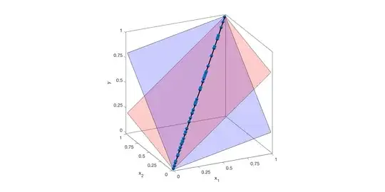

The issue here is multicollinearity. Thinking about the problem geometrically might give some intuition. Because there are two regressors, we're fitting a 2d plane to the data.
First, consider the case where $x_1$ and $x_2$ are perfectly correlated. In this example, I've plotted $y$ without any noise to make it easier to see what's happening, but the situation is the same when $y$ is noisy.
There's a single 'line of best fit' running through the data points, and any plane that intersects this line will produce the same predicted $y$ values (and therefore have the same goodness of fit). The plane can be rotated around this line, giving infinitely many solutions (e.g. the blue and red planes above).
