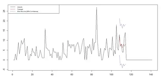

gave an "OK" forecast (see first graph).

But this gave worse results than the seasonal model I selected manually (see second graph). enter image description here
