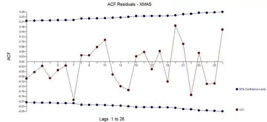

The plot of the residuals is here enter image description here with acf here enter image description here . The forecasts are here enter image description here
