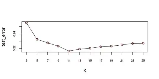

I got, for example, these results (cross validation with 5 fold):
  • First fold, best k = 11, accuracy = 0.785: fold1
  • Second fold, best k = 11, accuracy = 0.776: enter image description here
  • Third fold, best k = 11, accuracy = 0.786: enter image description here
  • Fourth fold, best k = 11, accuracy = 0.791: enter image description here
  • Fifth fold, best k = 9, accuracy = 0.793: enter image description here
