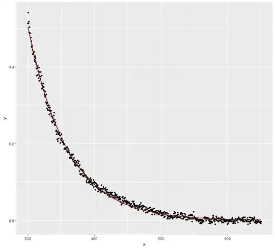

Use a selfstarting function:
ggplot(dt, aes(x = x, y = y)) +
  geom_point() +
  stat_smooth(method = "nls", formula = y ~ SSasymp(x, Asym, R0, lrc), se = FALSE)
resulting plot
fit <- nls(y ~ SSasymp(x, Asym, R0, lrc), data = dt)
summary(fit)
#Formula: y ~ SSasymp(x, Asym, R0, lrc)
#Parameters:
#       Estimate Std. Error  t value Pr(>|t|)
#Asym -0.0001302  0.0004693   -0.277    0.782
#R0   77.9103278  2.1432998   36.351   <2e-16 ***
#lrc  -4.0862443  0.0051816 -788.604   <2e-16 ***
#Signif. codes:  0 ‘***’ 0.001 ‘**’ 0.01 ‘*’ 0.05 ‘.’ 0.1 ‘ ’ 1
#Residual standard error: 0.007307 on 698 degrees of freedom
#Number of iterations to convergence: 0
#Achieved convergence tolerance: 9.189e-08
exp(coef(fit)[["lrc"]]) #lambda
#[1] 0.01680222
However, I would seriously consider if your domain knowledge doesn't justify setting the asymptote to zero. I believe it does and the above model doesn't disagree (see the standard error / p-value of the coefficient).

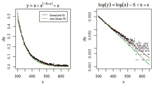

I have three additional remarks regarding some points in this question.
1: Why linearized model does not fit well the large values of $y$
Much better, but the model does not trace y values perfectly at low x values.
The linearized fit is not minimizing the same residuals. At the logarithmic scale the residuals for smaller values will be larger. The image below shows the comparison by plotting the y-axis on a log scale in the right image:
comparison
When necessary you could add weights to the least squares loss function.
2: Using linearized fit as starting values
After you have obtained estimates with your linearized fit you could have used these as starting point for the non linear fitting.*
