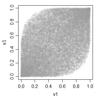

but not linearly, due to the monotonic transformation to uniformity

The relationship between the v-variables all look like this:
