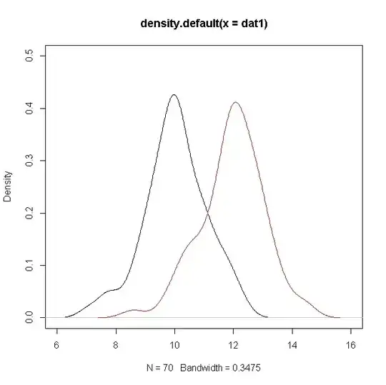

It is valid to compare several approaches, but not with the aim of choosing the one that favours our desires/believes.
My answer to your question is: It is possible that two distributions overlap while they have different means, which seems to be your case (but we would need to see your data and context in order to provide a more precise answer).
I am going illustrate this using a couple of approaches for comparing normal means.
1. $t$-test
Consider two simulated samples of size $70$ from a $N(10,1)$ and $N(12,1)$, then the $t$-value is approximately $10$ as in your case (See the R code below).
rm(list=ls())
# Simulated data
dat1 = rnorm(70,10,1)
dat2 = rnorm(70,12,1)
set.seed(77)
# Smoothed densities
plot(density(dat1),ylim=c(0,0.5),xlim=c(6,16))
points(density(dat2),type="l",col="red")
# Normality tests
shapiro.test(dat1)
shapiro.test(dat2)
# t test
t.test(dat1,dat2)
However the densities show a considerable overlapping. But remember that you are testing a hypothesis about the means, which in this case are clearly different but, due to the value of $\sigma$, there is an overlap of the densities.
