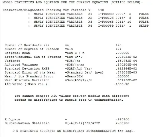

I used 140 monthly values from 2006/3 and obenter image description heretained the following reasonable model that used a log transform , three pulses and a seasonal pulse that commenced 2011/1 and ARIMA structure using AUTOBOX my tool of choice. It generated the following acf of the residuals enter image description here with 140 values the se of the acf is approx 1/12 or .07
Note that my reflections of a large sample size , the need for a power transform and the onset of unusual seasonal activity starting at period 59 of 140 came to pass. Just lucky I guess ! or maybe not so ! . This is the model summary enter image description here and forecast plot enter image description here
