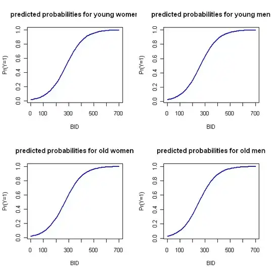

I have written some simple example code in R to make these plots. Let me note a few things: Because the 'action' takes place early, I only ran BID through 700 (but feel free to extend it to 2000). In this example, I am using the function you specify and taking the first category (i.e., female and young) as the reference category (which is the default in R). As @whuber notes in his comment, LR models are linear in log odds, thus you can use the first block of predicted values and plot as you might with OLS regression if you choose. The logit is the link function, which allows you to connect the model to probabilities; the second block converts log odds into probabilities via the inverse of the logit function, that is, by exponentiating (turning into odds) and then dividing the odds by 1+odds. (I discuss the nature of link functions and this type of model here, if you want more info.)
BID = seq(from=0, to=700, by=10)
logOdds.F.young = -3.92 + .014*BID
logOdds.M.young = -3.92 + .014*BID + .25*1
logOdds.F.old   = -3.92 + .014*BID         + .15*1
logOdds.M.old   = -3.92 + .014*BID + .25*1 + .15*1
pY.F.young = exp(logOdds.F.young)/(1+ exp(logOdds.F.young))
pY.M.young = exp(logOdds.M.young)/(1+ exp(logOdds.M.young))
pY.F.old   = exp(logOdds.F.old)  /(1+ exp(logOdds.F.old))
pY.M.old   = exp(logOdds.M.old)  /(1+ exp(logOdds.M.old))
windows()
  par(mfrow=c(2,2))
  plot(x=BID, y=pY.F.young, type="l", col="blue", lwd=2,
       ylab="Pr(Y=1)", main="predicted probabilities for young women")
  plot(x=BID, y=pY.M.young, type="l", col="blue", lwd=2,
       ylab="Pr(Y=1)", main="predicted probabilities for young men")
  plot(x=BID, y=pY.F.old, type="l", col="blue", lwd=2,
       ylab="Pr(Y=1)", main="predicted probabilities for old women")
  plot(x=BID, y=pY.M.old, type="l", col="blue", lwd=2,
       ylab="Pr(Y=1)", main="predicted probabilities for old men")
Which produces the following plot:
